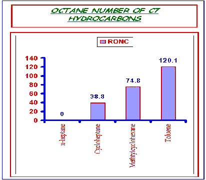

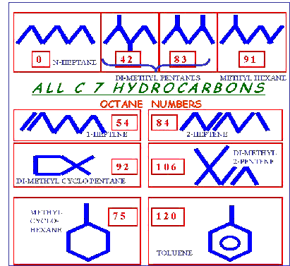

Extensive studies of octane numbers of individual compounds have brought to light several general rules.
1.    Normal(n) paraffins have the least desirable knocking characteristics, and these become progressively worse as the molecular weight increases.
2.    Iso (i) paraffins and naphthenes have higher octane than corresponding n-paraffins.
3.    Octane number of i-paraffins increases as the degree of branching of the chain is increased.
4.    Olefins have markedly higher octane numbers than the corresponding paraffins.
5.    Aromatics are hydrocarbons with the highest octane number for the same number of carbon atoms.
Thus it is clear that in order to have a large increase in octane number, it is necessary to transform paraffins and naphthenes into aromatics.

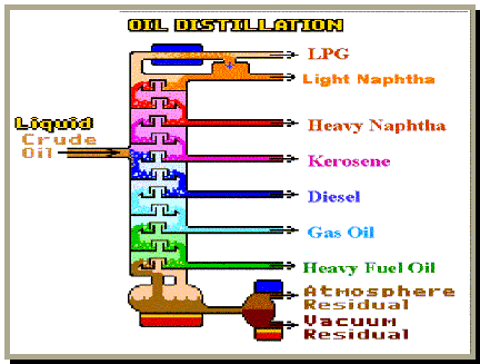

     In atmospheric distillation (Fig 1), the fractions identified as light naphtha, medium naphtha and heavy naphtha are the potential gasoline components.
     The clear RON of these components varies from 60 to 70 for light naphtha and 40 to 60 for medium and heavy naphtha. They cannot be used directly as gasoline, since gasoline RON requirements are 90 to 98.  The medium and heavy naptha streams are catalytic reforming feed stocks  and produce reformate having high octane value of 98-105.  Prior to  catalytic reforming, the addition of lead additives (TEL) provided a necessary octane boost. With the exception of a few countries, lead has been phased out due to its carcinogenic dangers .
Figure 1: Atmospheric Crude Distillation Unit

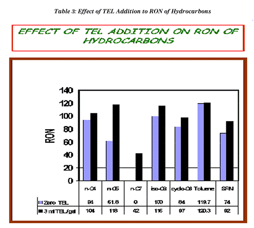

     In 1922,  Thomas Midgley Jr. discovered that, when added to gasoline in small quantities, Tetra Ethyl Lead (TEL), is an excellent anti-knock material (see Table 2 below).  Alkyl lead added to gasoline interferes with hydrocarbon chain branching in the intermediate temperature ranges where HO2 is the most important radical species.  Lead oxide, either as solid particles, or in the gas phase, reacts with HO2 and removes it from the available radical pool.   This deactivates the major chain branching reaction sequence that results in undesirable, easily-auto ignitable hydrocarbons and thus prevents knocking.   But if you keep adding alkyl lead compounds, the lead response of the gasoline decreases, and so there are economic limits to how much lead should be added.
     From 1922 until the 1970s, TEL had been added to conventional gasoline for octane boosting.  During the 1970s in the United States, catalystic emission control systems were fitted into new cars to reduce
carbon monoxide and nitrogen dioxide pollutants in automobile exhausts.  The lead antiknock compounds used in gasoline at the time were found to be detrimental to the performance of the catalytic emission control systems.  As a result, unleaded and low-lead gasolines were introduced into the U.S. to supplement the conventional gasolines already available.
     Another drawback to TEL addition was that the lead additive decomposed and was emitted as unconverted particulate lead.  In fact gasoline combustion accounted for 94.8% of atmospheric lead emissions. These lead emissions were toxic and caused slow poisoning of the nervous system, mental retardation in children and other health related problems.

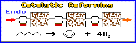

Focus on Catalytic Naphtha Reforming
     Catalytic naphtha reforming as a refinery process to upgrade medium and heavy naphtha into high octane reformate product for gasoline blending, is as important now as it has been for over 50 years of its commercial use.  The process gets its name from its ability to reform or reshape the molecular structure of the feedstock.  Low octane components in virgin naphthas, namely paraffins and naphthenes, are converted into higher octane components such as iso-paraffins and aromatics.  The octane number of a gasoline increases linearly with the increment in aromatic concentration.
     A typical feed to a reforming unit contains 45-70 % paraffins, 20-25 % napthenes, 4-14 % aromatics, and 0- 2 % olefins.   During the reforming reactions, aromatics increase to 60-75%, paraffins and naphthenes decrease to 20-45% and 1-8%, respectively, and olefins virtually disappear.   The main reactions via which these transformations occur are naphthene dehydrogenation, paraffin dehydrocyclization, and paraffin isomerisation.
     The naphtha feed stocks are heated to 500 degrees Celsius and flow through a series of fixed-bed catalytic reactors. Because the reactions are endothermic (absorb heat) additional heaters are installed between reactors to keep the reactants at the proper temperature.
     The workhorse for the reactions is typically a catalyst composed of minor amounts of several components, including platinum (Pt), supported on an oxide material such as alumina (Al2O3).   To prevent catalyst poisoning, the naphtha feedstock is first hydro-treated to remove any organic sulfur, nitrogen, oxygen and other metallic contaminants.  While catalysts are never consumed in reforming chemical reactions, they can be fouled, making them less effective over time.  The series of reactors used in semi-regenerative type reformers are designed so one may be disconnected and taken out of service for catalyst egeneration while other are still operating.
     In modern day facilities, continuous regenerative reformers operate at such low pressures that the rate of coke deposition is high.  Thus most plants use a continuous circulation and regeneration system for the catalyst.

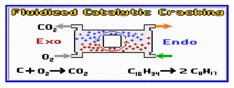

Focus on Fluidized Catalytic Cracking
     Fluidized Catalytic Cracking (FCC) takes long molecules and breaks them into much smaller molecules. The cracking reaction is very endothermic, and requires large amounts of heat.  Another problem is these reactions quickly foul the silica (SiO2) and alumina (Al2O3) catalyst by forming coke on their surface. However, the catalyst is continuously regenerated by using a fluidized bed to slowly carry the catalyst upwards, and then sending it to a regenerator where the coke can be burned off.  This system has the additional benefit of using the large amounts of heat liberated in the exothermic regeneration reaction to heat the cracking reactor.
      The FCC system is a brilliant reaction scheme, which turns two negatives (heating and fouling) into a positive, thereby making the process extremely economical.
     For years, Catalytic Reforming and FCC have served the purpose of obtaining motor gasoline with desired octane without addition of any lead additives.  However, in view of stricter regulations on aromatics content, benzene in particular, catalytic reforming has come under attack as the reformate typically contains 60-70 % aromatics and 5-6 % benzene.  FCC has also faced a disadvantage as cracked FCC gasoline contains high levels of aromatics, olefins and sulfur. Operation changes in both the processes as well as development of new processes has been the focus of research in order to meet new motor gasoline specifications.
