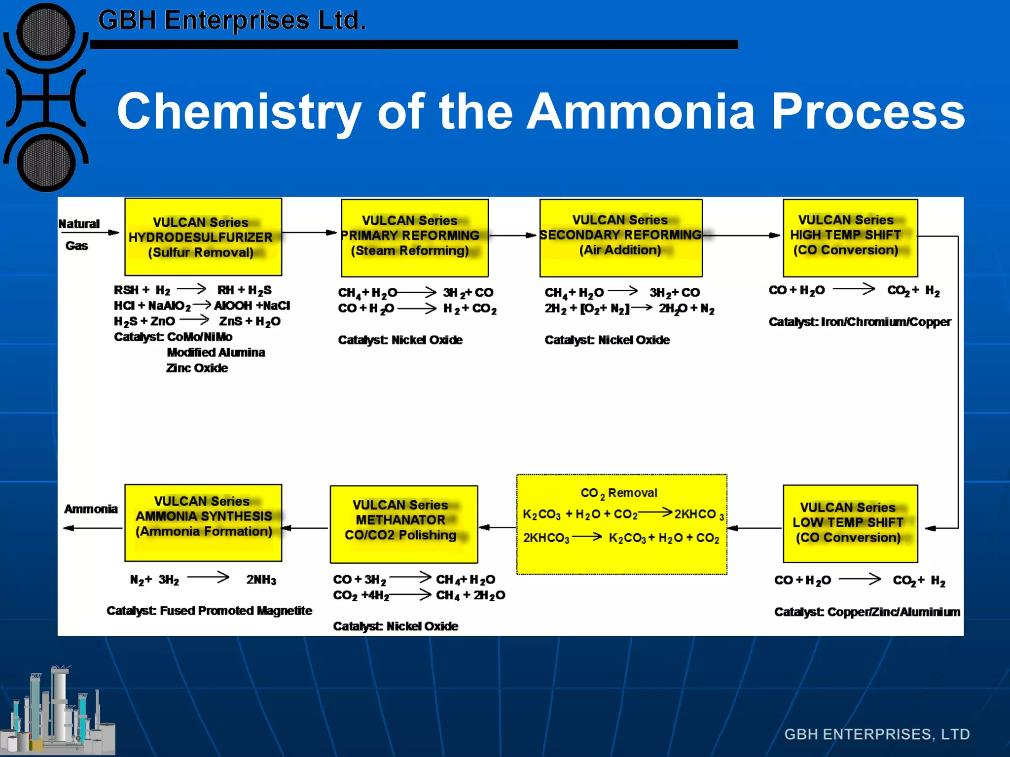

Hello im having trouble trying to design a system that can be used to separate the syngas products of steam reforming
the gas stream contain CO2, H2, N2 and O2 . and trying to separate each gas  into an individual stream.
i had tried using MDEAmine to remove CO2 in an absorption column and cryogenic distillation column to Separate the other gases CO2,O2,H2 . Any help in generating an aspen file is appreciated for the process is appreciated. Mass flowrate  is 9139kg/hr with compositions CO2 47.65%,H2 7.43%, N2 38.91%,O2 6.01%

See if the SEP unit op in AspenPlus will be good enough for your CO2 separation. You give the unit spec on how much CO2 remains and set the temperature and pressure of the vapor outlet. You should know the answer you want out of the amine absorber and the SEP unit can give you that answer without trying to converge a distillation column. You will then need to add water to the model to saturate the vapor which leaves the amine solution so you may need to add a dryer to your process. Cryogenic distillation is not recommended for your process. Maybe a membrane unit would be better for separating the hydrogen. The oxygen/nitrogen product has little value so vent that stream without further separation. Model the amine system for sizing after your initial material balance is complete. [And do confirm you really have oxygen in the feed and get rid of it before further processing.]

Air is usually added in such a process immediately after the steam reformer at a high temperature over catalyst where the oxygen reacts to completion. You should be able to find online descriptions and material balances for the ammonia process.

There is no reason to separate the H2 from the N2 since they will be reactants in the same reactor. Just get the proportions of nitrogen and hydrogen correct and send the stream to the reactor loop after removing the other components. There should be no elemental oxygen as it will all be reacted to CO or CO2 or H2O. Convert the CO to CO2 then remove the CO2 with an amine system. Convert any remaining CO and CO2 to CH4. For student work, an aqueous MEA system will be easiest to model for CO2 removal. Here is a diagram showing the main reaction units for the ammonia process: https://image.slides...eets-2-2048.jpg There is plenty of references inside the internet on the ammonia process. Snam urea process has flowsheets also. You can try to reinvent these processes but you will likely run into dead ends. The Haber-Bosch ammonia process is over 100 years old and quite reliable.
